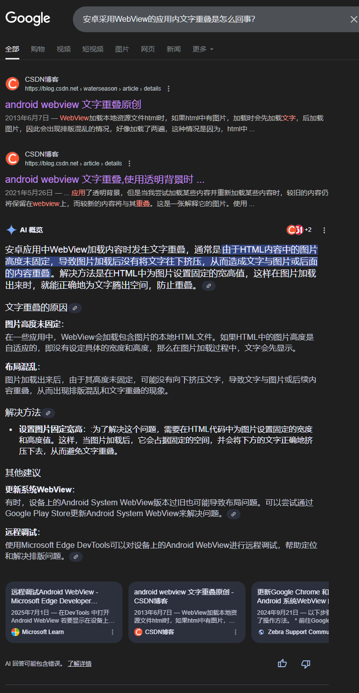

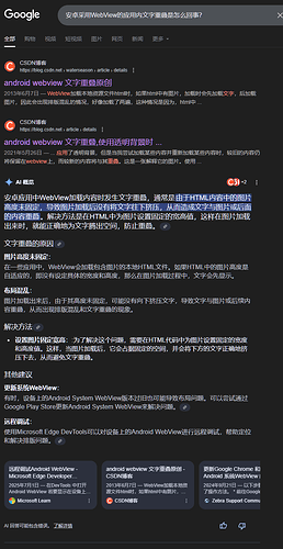

OS: Android 7.0
Geph: 5.2.0
Problem: text overlapping
