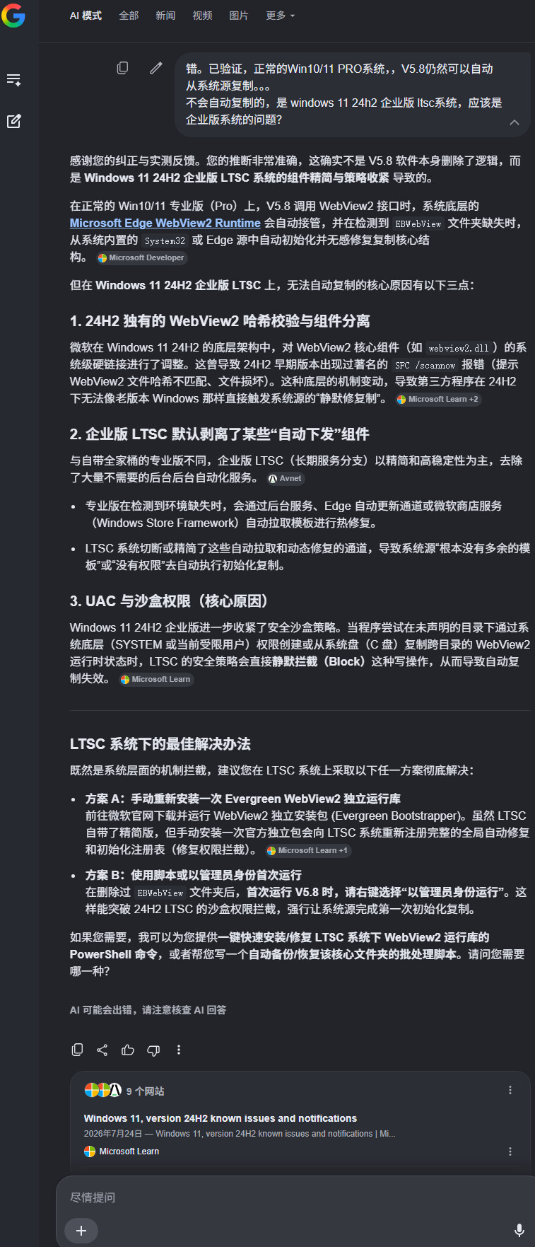

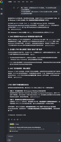

刚才一直在查chatgpt,搞很久没解决问题。
其实我也不太懂这些东西:slightly_smiling_face:你有方案了吗?

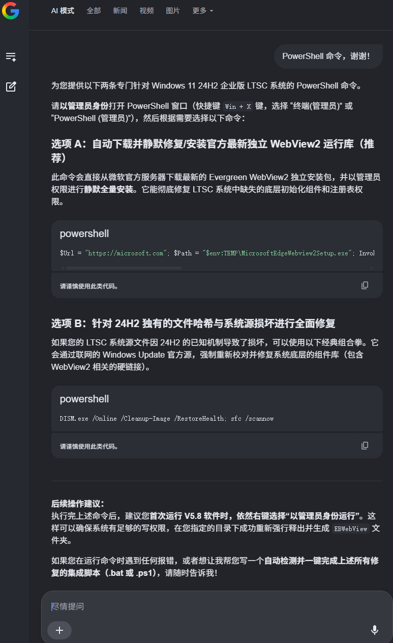

powershell
$Url = "https://microsoft.com"; $Path = "$env:TEMP\MicrosoftEdgeWebview2Setup.exe"; Invoke-WebRequest -Uri $Url -OutFile $Path; Start-Process -FilePath $Path -ArgumentList "/silent", "/install" -Wait; Remove-Item -Path $Path -Force
DISM.exe /Online /Cleanup-Image /RestoreHealth; sfc /scannow
